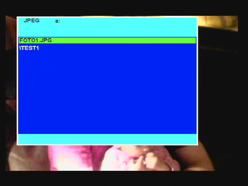

Den Stick SanDisk Cruzer Micro 1GB neu in FAT formatiert und mit einem Foto.jpg im root:
Resetting Port
Enabling Port
USB_AttachnewDevice Fullspeed:1
USB_SetAddress 03
Reading Device Descriptor
This endpoint supports a maxtransfersize of 40
Device Descriptor:
  UsbSpec 0200 Class 00 SubClass 00 Prot 00 MaxPacket 40
  Vendor 0781 Product 5151 Release 0200
  ManuString 01 ProductString 02 SerialString 03
  NumConfigs 01
Manufacturer:
Product:
Serial:
Config 0:
Interfaces: 01 ConfigVal 01 StringInfo 00 Bus-powered  94mA
  IF: Num 00 Alt 00 EPs 02 Class 08 SubClass 06 Prot 50 StringIdx 00
    EP: Addr 81 Bulk    MaxSize 0040 PollInterval 00
    EP: Addr 02 Bulk    MaxSize 0040 PollInterval 00
Filesys Mount
Bootsect
Partition Table
Boot StartCHS Type EndCHS StartSect  EndSect Filesystem
 80   010100  06   03C83E  00000008 001EE7F7 FAT16b
 00   000000  00   000000  00000000 00000000 Empty
Mounting Drive A:
Bootsect
FAT12/16 BPB
Sig16 found
Mount_FAT_12_16 00000008
PartInfo: 004AC448
Byte per Sector 0200
Sector per Cluster 32
Res Sectors 0008
Num FATs 2
FatEntries 0200
TotalSectors 0000
Media Descriptor 248
Sectors per Fat 00F8
Sectors per Track 003F
Number of Heads FF00
Hidden Sectors 08000000
TotalSectors(Large) F7E71E00
Extended BPB present
Volume Serial 20548E48
Volume Label NO NAME    FAT16   3ɎѼð{ŽÙ¸
FOTO    .JPG <     A > Foto.jpgÿÿÿÿ
ret PartInfo: 004AC448
Volume successfully mounted
VolMgr_SendPNPEvent 05 0029F84C 00000008
Filesys Wait
 pszTempPath: ÿÿÿÿô
 pszPath:a:
 pszTempPath: a:\*.*
 pszPath:a:
File_FindFirst: a:\*.* 003EA9A4
Searching the root dir
open
Attempt to open root directory
jpeg.jpg [ 41.72 KiB | 8952-mal betrachtet ]

 pszTempPath: %7
 pszPath:a:
 pszTempPath: a:\*.*
 pszPath:a:
open
 +++ nr_of_jpg_files :1 file_name:TEST1  Size:0
 pszTempPath: a:\*.*
 pszPath:a:
 pszTempPath: a:\*.*
 pszPath:a:
open
 +++ nr_of_jpg_files :2 file_name:TEST1  Size:0
 [!first_loop] 1 nr_of_jpg_files :2
 file_name:TEST1
 [!first_loop] 2 GOAL_JPEG_DIR ->_this->num_item :2
 GOAL_JPEG_DIR->items:\TEST1
 pszTempPath:
 pszPath:a:\TEST1\
 pszTempPath: a:\TEST1\*.*
 pszPath:a:\TEST1\
File_FindFirst: a:\TEST1\*.* 003EA7C4
open TEST1
 +++ nr_of_jpg_files :0 file_name:..  Size:0
 pszPath:a:\TEST1\
 pszPath:a:\TEST1\
open TEST1
 +++ nr_of_jpg_files :3 file_name:..  Size:0
 [!first_loop] 1 nr_of_jpg_files :3
 file_name:..
 [!first_loop] 2 GOAL_JPEG_DIR ->_this->num_item :3
 GOAL_JPEG_DIR->items:\..
Scheinbar mag er keine Bilder *.jpg nur Bolder mit *.JPG im root??? In unterordnern gehen *.jpg Bilder aber???

Die letzte, ich hatte dann nur das Design an den JPEG Fenster geändert.
