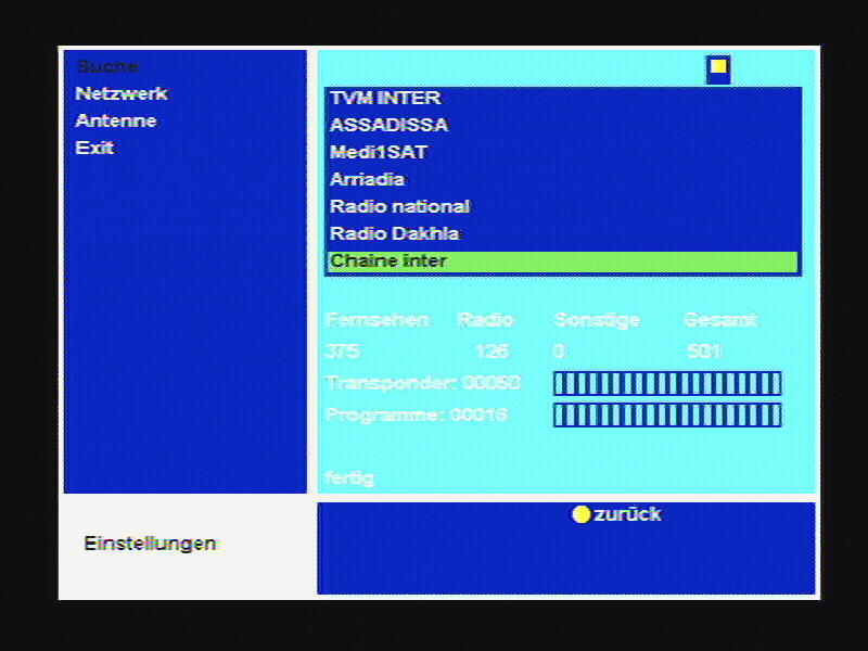

Zu beachten, die neuen Suchlaufstarttransponder werden erst nach einem Wersreset über nommen. Sonst startet der Suchlauf wie in der letzten installierten SW Version!
Probleme.
- Autoscan ohne Funktion
- NIT Suche HB findet nur 4 TR

[NIT_scan_tune][SCAN_ACTIVE]
[scan_tune]
------- scan start tune -------------
[SCAN_TASK][MSG_CLASS_USER][SCAN_TUNE]
######################## [Tune Parameter] ##################
[TR   ]Frequency:Orbit:WE:Pol:Mod:SRate:FEC_I:O_FL
[TR042]012476000:00130:01:000:001:27500:00000:0000
-------------------- [Diseqc Settings] ---------------------
Mode:Port:SW2_1:SW4_1:Cas:Type:Pow:22k:High :Low
0001:0001:00000:00001:000:0000:001:002:10600:09750
[SCAN_TASK][MSG_CLASS_CONTROL][MSG_CLASS_CONTROL]C_PROGRAM_OFF
[SCAN_TASK][MSG_CLASS_CONTROL][MSG_CLASS_CONTROL]C_PROGRAM_ON SDT
[SCAN_TASK][MSG_CLASS_SI][GX_DVB_SDT]AUSGABE_SDT:
  SNR: TSID:ONID:CHNUM:        SID:TYPE:FLAG:         Servicename:Provider
    0:
    0:
    0: 9800: 318:    0:    1(   1):   1:   1:        AL MAGHRIBIA:PRVDR
    1:
    1: 9800: 318:    0:    2(   2):   1:   1:         TVM INTER+L:PRVDR
    2:
    2: 9800: 318:    0:    3(   3):   1:   1:            AL Aoula:PRVDR
    3:
    3: 9800: 318:    0:    4(   4):   1:   1:            ARRABIAA:PRVDR
    4:
    4: 9800: 318:    0:    5(   5):   1:   1:           TVM INTER:PRVDR
    5:
    5: 9800: 318:    0:    6(   6):   1:   1:           ASSADISSA:PRVDR
    6:
    7:
    7: 9800: 318:    0:    8(   8):   1:   1:            Medi1SAT:PRVDR
    8:
    8: 9800: 318:    0:   10(   a):   1:   1:            Arriadia:PRVDR
    9:
    9: 9800: 318:    0:   11(   b):   2:   1:      Radio national:PRVDR
   10:
   10: 9800: 318:    0:   12(   c):   2:   1:        Radio Dakhla:PRVDR
   11:
   11: 9800: 318:    0:   14(   e):   2:   1:        Chaine inter:PRVDR
   12:
   12: 9800: 318:    0:   15(   f):   2:   1:             Amazigh:PRVDR
   13:
   13: 9800: 318:    0:   16(  10):   2:   1:    Radio Mohamed VI:PRVDR
   14:
   14: 9800: 318:    0:  177(  b1):   2:   1:           Radio Fes:PRVDR
   15:
   15: 9800: 318:    0:  241(  f1):   1:   1:          arriadia 2:PRVDR
